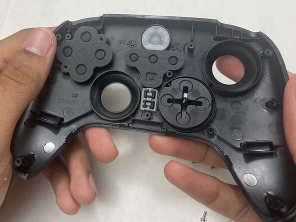

  6. 8BitDo Ultimate Wireless D-Pad Replacement: étape 6, image 1 de 1
    • Carefully lift the D-pad conductive pad out of the shell.

  7. 8BitDo Ultimate Wireless D-Pad Replacement: étape 7, image 1 de 2 8BitDo Ultimate Wireless D-Pad Replacement: étape 7, image 2 de 2
    • Remove the directional pad.
