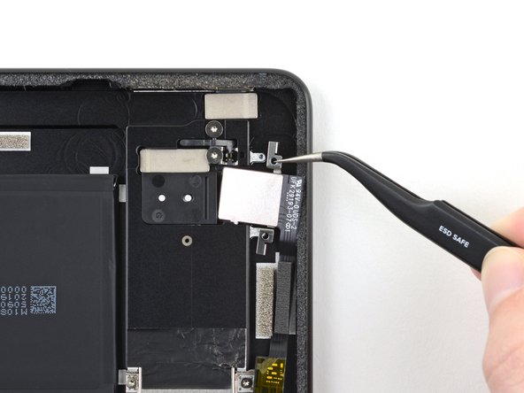

  16. Microsoft Surface Pro X SIM Card Reader Replacement, Remove the display cable shield: étape 16, image 1 de 3 Microsoft Surface Pro X SIM Card Reader Replacement, Remove the display cable shield: étape 16, image 2 de 3 Microsoft Surface Pro X SIM Card Reader Replacement, Remove the display cable shield: étape 16, image 3 de 3
    Outil utilisé dans cette étape :
    • Insert a tine of a pair of pointed tweezers under the bottom right corner of the display cable shield (where the display cable is oriented down).
    • Lift up the corner to detach it from the screen.
  17. Microsoft Surface Pro X SIM Card Reader Replacement: étape 17, image 1 de 2 Microsoft Surface Pro X SIM Card Reader Replacement: étape 17, image 2 de 2
    • Repeat the previous step for the bottom right corner.
  18. Microsoft Surface Pro X SIM Card Reader Replacement: étape 18, image 1 de 1
    • Remove the display cable shield from the screen.
    • If the display cable shield isn't completely detached from the screen, pry up additional areas around the edges of the shield.
