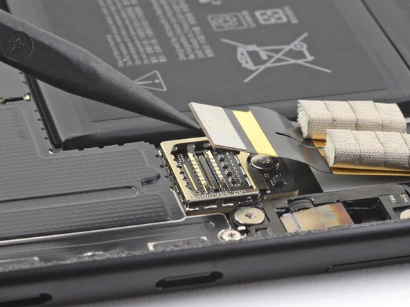

  19. Microsoft Surface Pro X SSD Port Replacement, Disconnect the screen: étape 19, image 1 de 2 Microsoft Surface Pro X SSD Port Replacement, Disconnect the screen: étape 19, image 2 de 2
    • Insert the pointed end of a spudger under the right side of the display cable press connector.
    • Lift up the right side of the press connector to detach it from the display cable socket on the screen.
  20. Microsoft Surface Pro X SSD Port Replacement: étape 20, image 1 de 2 Microsoft Surface Pro X SSD Port Replacement: étape 20, image 2 de 2
    • Repeat the previous step on the left side of the display cable connector to fully disconnect it from the screen.
    • To re-attach press connectors like this one, carefully align and press down on one side until it clicks into place, then repeat on the other side. Do not press down on the middle. If the connector is misaligned, the pins can bend, causing permanent damage.

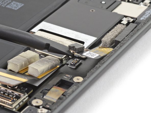

    • Take care not to puncture or bend the battery with any tools while removing the SSD port—a punctured or bent battery may leak dangerous chemicals or cause a thermal event.
    • Insert one tine of a pair of pointed tweezers under the top left corner of the SSD port connector's shield (where the cable is oriented down).
    • Lift up the corner to detach it from the frame.

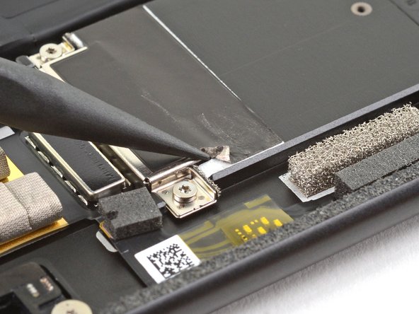

  26. Microsoft Surface Pro X SSD Port Replacement, Remove the shield: étape 26, image 1 de 2 Microsoft Surface Pro X SSD Port Replacement, Remove the shield: étape 26, image 2 de 2
    • Remove the SSD port connector's shield.
    • If the shield isn't completely detached from the frame, pry up additional areas on the edges of the shield.

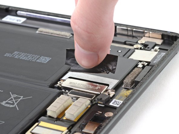

  27. Microsoft Surface Pro X SSD Port Replacement, Remove the SSD port sticker: étape 27, image 1 de 2 Microsoft Surface Pro X SSD Port Replacement, Remove the SSD port sticker: étape 27, image 2 de 2
    • If you are going to reinstall this sticker during reassembly, try to keep it as intact as possible.
    • Use the pointed end of a spudger to lift up a corner of the black sticker covering the SSD port.
  28. Microsoft Surface Pro X SSD Port Replacement: étape 28, image 1 de 2 Microsoft Surface Pro X SSD Port Replacement: étape 28, image 2 de 2
    • Remove the SSD port sticker.

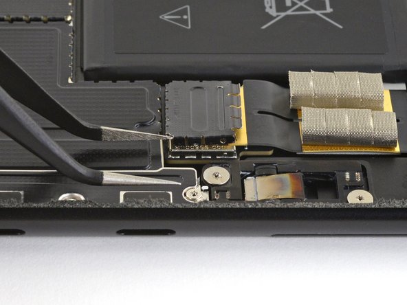

  29. Microsoft Surface Pro X SSD Port Replacement, Disconnect the SSD port: étape 29, image 1 de 2 Microsoft Surface Pro X SSD Port Replacement, Disconnect the SSD port: étape 29, image 2 de 2
    • Use the pointed end of a spudger to disconnect the SSD port's press connector from its socket.

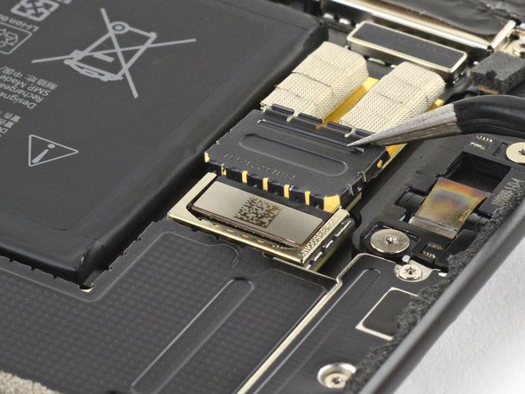

  30. Microsoft Surface Pro X SSD Port Replacement, Disconnect the SIM card reader: étape 30, image 1 de 2 Microsoft Surface Pro X SSD Port Replacement, Disconnect the SIM card reader: étape 30, image 2 de 2
    • Use the flat end of a spudger to disconnect the SIM card reader's press connector from its socket.
