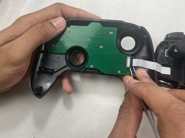

  4. 8BitDo Ultimate Wireless Battery Replacement: étape 4, image 1 de 3 8BitDo Ultimate Wireless Battery Replacement: étape 4, image 2 de 3 8BitDo Ultimate Wireless Battery Replacement: étape 4, image 3 de 3
    • The ribbon cable is secured with a locking tab connector.
    • Use tweezers to unlock the locking tab on the ribbon cable connector, then gently disconnect the ribbon cable.

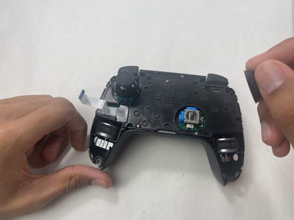

  5. 8BitDo Ultimate Wireless Battery Replacement, Battery: étape 5, image 1 de 1
    • Grip each analog stick cap firmly and pull straight up to remove them.
