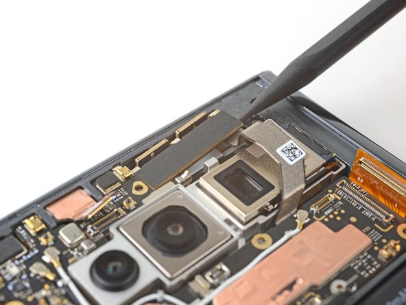

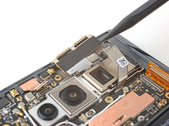

  24. Google Pixel Fold 5G mmWave Antenna Replacement, Reposition the graphite sheet: étape 24, image 1 de 3 Google Pixel Fold 5G mmWave Antenna Replacement, Reposition the graphite sheet: étape 24, image 2 de 3 Google Pixel Fold 5G mmWave Antenna Replacement, Reposition the graphite sheet: étape 24, image 3 de 3
    Outil utilisé dans cette étape :
    Tesa 61395 Tape
    $8.95
    • The graphite sheet is very fragile. Be gentle peeling the graphite sheet in this step, especially if you're reusing it.
    • The graphite sheet is lightly adhered to the logic board.
    • Peel the bottom of the graphite sheet toward the top of the phone until you can access the bottom bracket.
    • Use your hands, or tape with light adhesive, to keep the graphite sheet out of the way.

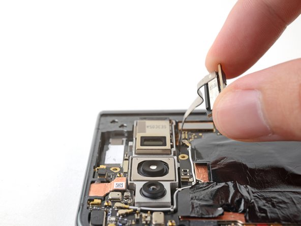

  27. Google Pixel Fold 5G mmWave Antenna Replacement, Remove the bottom bracket: étape 27, image 1 de 3 Google Pixel Fold 5G mmWave Antenna Replacement, Remove the bottom bracket: étape 27, image 2 de 3 Google Pixel Fold 5G mmWave Antenna Replacement, Remove the bottom bracket: étape 27, image 3 de 3
    • Use tweezers, or your fingers, to pull the bottom bracket toward the bottom edge of the phone and release its clip.
    • Remove the bottom bracket.
    • During reassembly, reinsert the bottom bracket clip under its slot in the logic board before aligning its screw holes.

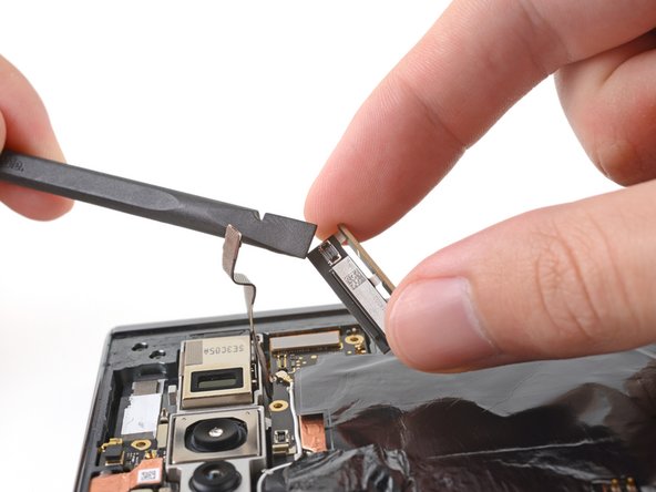

  28. Google Pixel Fold 5G mmWave Antenna Replacement, Disconnect the base battery: étape 28, image 1 de 2 Google Pixel Fold 5G mmWave Antenna Replacement, Disconnect the base battery: étape 28, image 2 de 2
    • There are two batteries you need to disconnect, one for each half of the phone.
    • Use the point of a spudger to pry up and disconnect the base battery cable press connector.

  35. Google Pixel Fold 5G mmWave Antenna Replacement, Separate the adhesive: étape 35, image 1 de 3 Google Pixel Fold 5G mmWave Antenna Replacement, Separate the adhesive: étape 35, image 2 de 3 Google Pixel Fold 5G mmWave Antenna Replacement, Separate the adhesive: étape 35, image 3 de 3
    Tesa 61395 Tape
    $8.95
    • The 5G mmWave antenna is lightly adhered to the frame.
    • Insert the point of a spudger between the frame and the right edge of the 5G mmWave antenna.
    • Pry up to separate the adhesive.
    • During reassembly, if your adhesive is still intact and sticky, you can reuse it. Otherwise, follow this guide to replace the adhesive with custom cut strips.
    • If you don't have custom cut adhesive strips, use double-sided tape, like Tesa Tape, to secure the antenna to the frame.

  36. Google Pixel Fold 5G mmWave Antenna Replacement, Reposition the antenna: étape 36, image 1 de 2 Google Pixel Fold 5G mmWave Antenna Replacement, Reposition the antenna: étape 36, image 2 de 2
    • Pull the 5G mmWave antenna toward the bottom of the phone to expose its cable press connector.
    Demander à FixBot

  37. Google Pixel Fold 5G mmWave Antenna Replacement, Disconnect the antenna: étape 37, image 1 de 3 Google Pixel Fold 5G mmWave Antenna Replacement, Disconnect the antenna: étape 37, image 2 de 3 Google Pixel Fold 5G mmWave Antenna Replacement, Disconnect the antenna: étape 37, image 3 de 3
    • Use the flat end of a spudger to pry up and disconnect the 5G mmWave antenna cable press connector.
    • Remove the antenna.

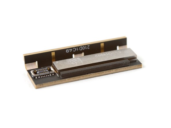

Compare your new replacement part to the original part—you may need to transfer remaining components or remove adhesive backings from the new part before you install it.
