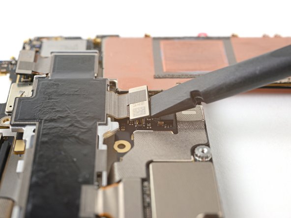

    20. Google Pixel Fold Rear Cameras Replacement, Disconnect the back glass cable: étape 21, image 1 de 2 Google Pixel Fold Rear Cameras Replacement, Disconnect the back glass cable: étape 21, image 2 de 2
      • Use the point of a spudger to pry up and disconnect the back glass cable from the motherboard.
      • To re-attach press connectors like this one, carefully align and press down on one side until it clicks into place, then repeat on the other side. Don't press down in the middle. If the connector is misaligned, the pins can bend and cause permanent damage.

    1. Google Pixel Fold Rear Cameras Replacement, Disconnect the rear cameras: étape 61, image 1 de 3 Google Pixel Fold Rear Cameras Replacement, Disconnect the rear cameras: étape 61, image 2 de 3 Google Pixel Fold Rear Cameras Replacement, Disconnect the rear cameras: étape 61, image 3 de 3
      • Use the flat end of a spudger to pry up and disconnect the wide, ultrawide, and telephoto camera press connectors.

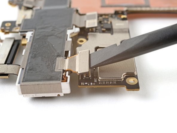

    2. Google Pixel Fold Rear Cameras Replacement, Remove the rear cameras: étape 62, image 1 de 3 Google Pixel Fold Rear Cameras Replacement, Remove the rear cameras: étape 62, image 2 de 3 Google Pixel Fold Rear Cameras Replacement, Remove the rear cameras: étape 62, image 3 de 3
      • Remove the rear cameras.
