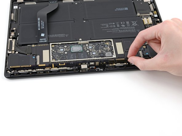

  21. Microsoft Surface Pro X Front Camera Replacement, Remove the screen: étape 21, image 1 de 1
    • Remove the screen from the frame.

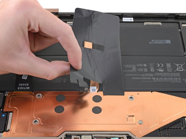

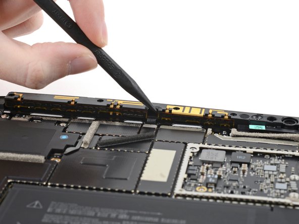

  25. Microsoft Surface Pro X Front Camera Replacement, Remove the heat sink sticker: étape 25, image 1 de 2 Microsoft Surface Pro X Front Camera Replacement, Remove the heat sink sticker: étape 25, image 2 de 2
    • If you are going to reinstall this sticker during reassembly, try to keep it as intact as possible.
    • Lift up the edge of the heat sink sticker closest to the bottom edge of the Surface.
  26. Microsoft Surface Pro X Front Camera Replacement: étape 26, image 1 de 2 Microsoft Surface Pro X Front Camera Replacement: étape 26, image 2 de 2
    • Lift up the center of the sticker.
  27. Microsoft Surface Pro X Front Camera Replacement: étape 27, image 1 de 3 Microsoft Surface Pro X Front Camera Replacement: étape 27, image 2 de 3 Microsoft Surface Pro X Front Camera Replacement: étape 27, image 3 de 3
    • Lift up one side of the sticker attached to the heat sink.
    • Repeat for the other side. The sticker should now be fully detached.
    • Remove the sticker.

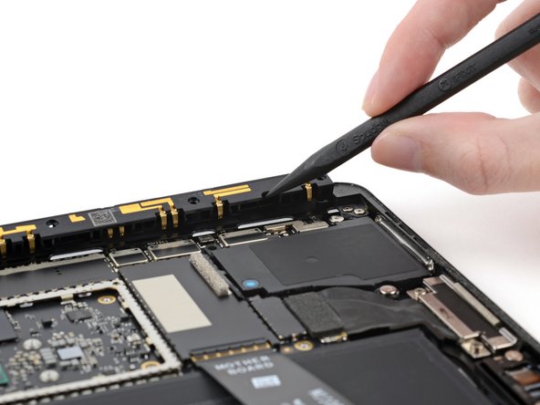

  28. Microsoft Surface Pro X Front Camera Replacement, Remove the screw stickers: étape 28, image 1 de 2 Microsoft Surface Pro X Front Camera Replacement, Remove the screw stickers: étape 28, image 2 de 2
    Outil utilisé dans cette étape :
    • If you are going to reinstall these stickers during reassembly, try to keep them as intact as possible. These stickers can tear easily during removal.
    • Use an opening tool to lift up the edge of one of the small black stickers covering the four screws in the center of the heat sink.
    • You only need to lift the edge enough to grip it with tweezers.

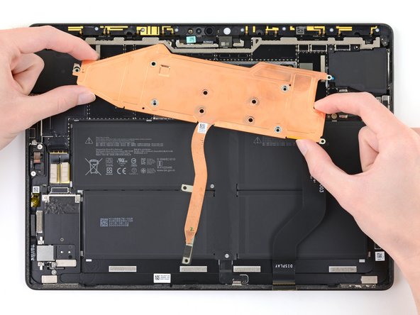

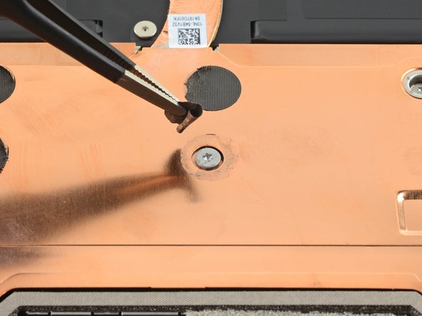

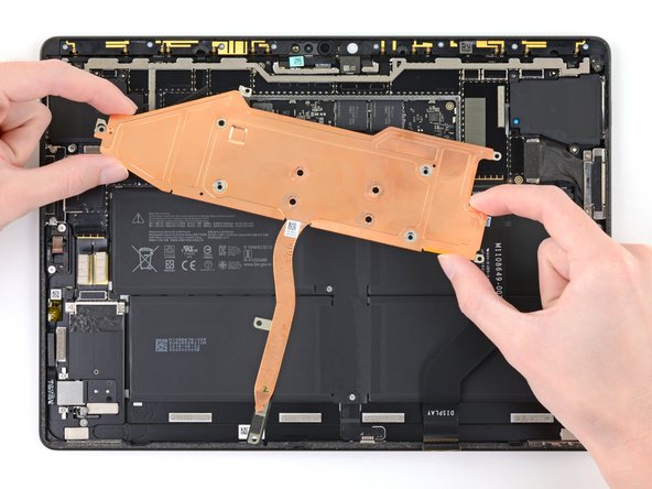

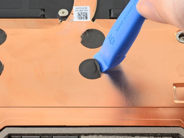

  31. Microsoft Surface Pro X Front Camera Replacement, Remove the heat sink: étape 31, image 1 de 2 Microsoft Surface Pro X Front Camera Replacement, Remove the heat sink: étape 31, image 2 de 2
    • The heat sink is adhered to the CPU with thermal paste.
    • Insert an opening pick about 2 mm under the heat sink at its bottom edge directly to the left of the display cable.
    • The opening pick should be between the heat sink and the frame surrounding the motherboard.
    • Slide the opening pick to the left toward the heat pipe to detach the heat sink from the CPU.

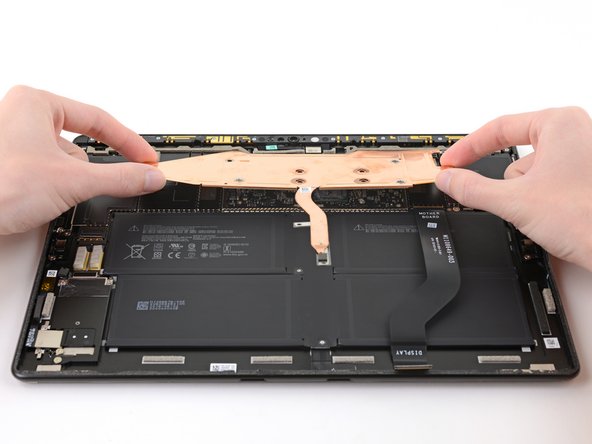

  32. Microsoft Surface Pro X Front Camera Replacement: étape 32, image 1 de 2 Microsoft Surface Pro X Front Camera Replacement: étape 32, image 2 de 2
    • Swing the bottom edge of the heat sink up so that it is at about a 10° angle with the frame.
  33. Microsoft Surface Pro X Front Camera Replacement: étape 33, image 1 de 3 Microsoft Surface Pro X Front Camera Replacement: étape 33, image 2 de 3 Microsoft Surface Pro X Front Camera Replacement: étape 33, image 3 de 3

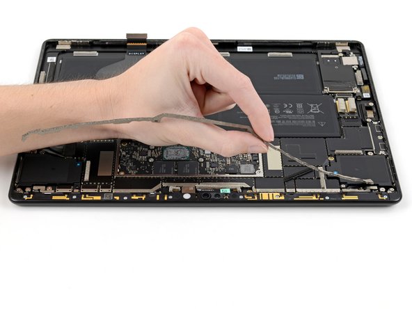

  34. Microsoft Surface Pro X Front Camera Replacement, Remove the foam adhesive: étape 34, image 1 de 3 Microsoft Surface Pro X Front Camera Replacement, Remove the foam adhesive: étape 34, image 2 de 3 Microsoft Surface Pro X Front Camera Replacement, Remove the foam adhesive: étape 34, image 3 de 3
    • Remove the foam adhesive strip from the Surface.

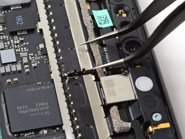

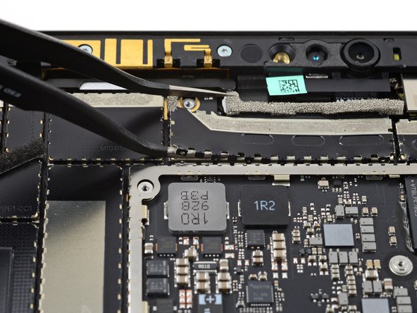

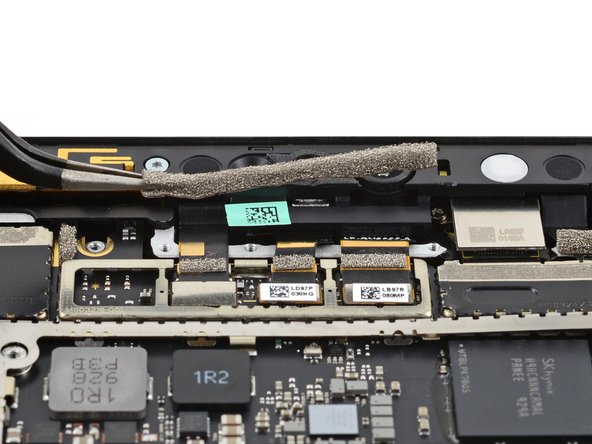

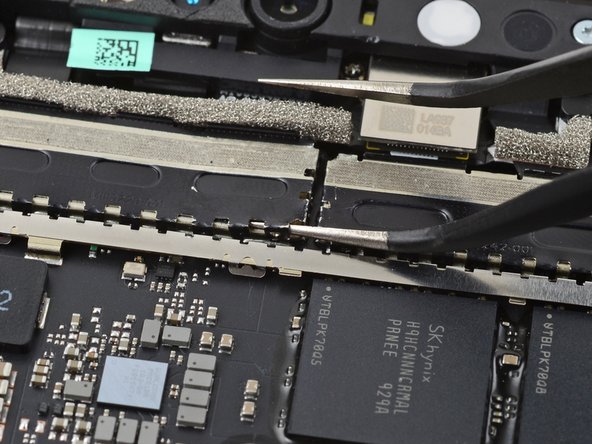

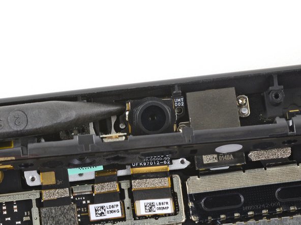

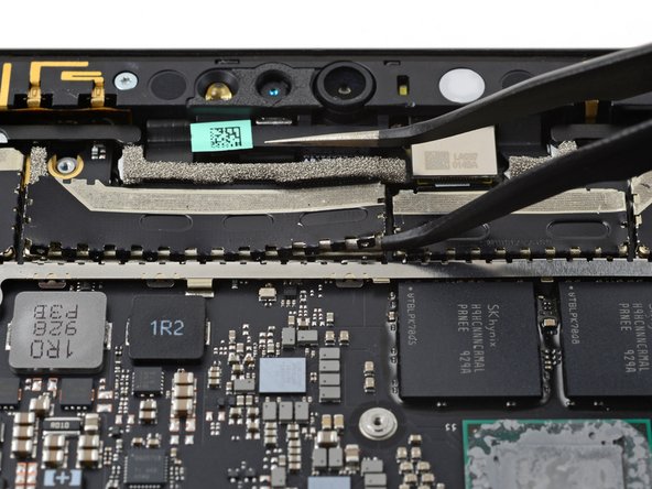

  35. Microsoft Surface Pro X Front Camera Replacement, Remove the front camera shield: étape 35, image 1 de 2 Microsoft Surface Pro X Front Camera Replacement, Remove the front camera shield: étape 35, image 2 de 2
    • Insert one tine of a pair of pointed tweezers under one corner of the shield covering the front camera connector.
    • Lift up the corner to detach it from the frame.
    • If you are going to reuse this shield, try to avoid excessively bending it during removal.

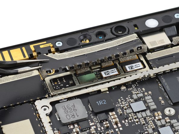

  36. Microsoft Surface Pro X Front Camera Replacement: étape 36, image 1 de 3 Microsoft Surface Pro X Front Camera Replacement: étape 36, image 2 de 3 Microsoft Surface Pro X Front Camera Replacement: étape 36, image 3 de 3
    • Repeat the previous step for the other three corners of the shield.

    • Slide one tine of a pair of pointed tweezers under the left edge of the shield to further detach it from the frame.
    • Repeat this for the right edge of the shield.
  38. Microsoft Surface Pro X Front Camera Replacement: étape 38, image 1 de 3 Microsoft Surface Pro X Front Camera Replacement: étape 38, image 2 de 3 Microsoft Surface Pro X Front Camera Replacement: étape 38, image 3 de 3
    • Slide one tine of a pair of pointed tweezers under the bottom left edge of the shield to further detach it from the frame.
    • Repeat for the bottom right edge.
  39. Microsoft Surface Pro X Front Camera Replacement: étape 39, image 1 de 2 Microsoft Surface Pro X Front Camera Replacement: étape 39, image 2 de 2
    • Insert one tine of a pair of pointed tweezers into the divot in one of the tabs on the bottom edge of the shield.
    • You could also insert the tine under the bottom edge of the shield.
    • Lift up the bottom edge to detach it from the frame.
  40. Microsoft Surface Pro X Front Camera Replacement: étape 40, image 1 de 3 Microsoft Surface Pro X Front Camera Replacement: étape 40, image 2 de 3 Microsoft Surface Pro X Front Camera Replacement: étape 40, image 3 de 3
    • Use a pair of tweezers to lift up the bottom edge of the shield so that it is at a 30° angle with the frame.
    • This will detach the top edge of the shield from the frame.
    • Remove the front camera shield from the frame.
  41. Microsoft Surface Pro X Front Camera Replacement, Remove the camera foam strip: étape 41, image 1 de 2 Microsoft Surface Pro X Front Camera Replacement, Remove the camera foam strip: étape 41, image 2 de 2
    • Use a pair of tweezers to remove the foam strip adhered to the front camera, Windows Hello face camera, and left microphone cables.
  42. Microsoft Surface Pro X Front Camera Replacement, Disconnect the front camera: étape 42, image 1 de 2 Microsoft Surface Pro X Front Camera Replacement, Disconnect the front camera: étape 42, image 2 de 2
    • Use the pointed end of a spudger to disconnect the front camera press connector from its socket.
  43. Microsoft Surface Pro X Front Camera Replacement, Remove the front-facing sensor bar screws: étape 43, image 1 de 1
    • Depending on what component you are repairing, different shields on the motherboard may be removed at this point. For example, the shield covering the rear-facing camera connector has been removed in this step's image.
    • Use a T3 Torx screwdriver to remove the eight 5.5 mm screws securing the front-facing sensor bar.
  44. Microsoft Surface Pro X Front Camera Replacement, Dislodge the front-facing sensor bar: étape 44, image 1 de 2 Microsoft Surface Pro X Front Camera Replacement, Dislodge the front-facing sensor bar: étape 44, image 2 de 2
    • Insert the pointed end of a spudger into the gap on the right side of the sensor bar between the rightmost screw hole and the adjacent screw hole.
    • Lift up the right side of the sensor bar to dislodge it from the frame.
    • You only need to lift the sensor bar so that it is loose in the frame. Don't try to remove the front sensor bar—it is still attached to the Surface by a cable that connects under the motherboard.
  45. Microsoft Surface Pro X Front Camera Replacement: étape 45, image 1 de 2 Microsoft Surface Pro X Front Camera Replacement: étape 45, image 2 de 2
    • Repeat the last step for the gap in the sensor bar between the second and third screw hole from the left.
    • This gap is where the sensor bar's cable is located.
  46. Microsoft Surface Pro X Front Camera Replacement, Lift the front-facing sensor bar: étape 46, image 1 de 2 Microsoft Surface Pro X Front Camera Replacement, Lift the front-facing sensor bar: étape 46, image 2 de 2
    • Lift the sensor bar 90° so that it's perpendicular to the frame.
    • Don't push the sensor bar past 90° and don't rotate it horizontally to avoid damaging the cable connecting it to the motherboard.

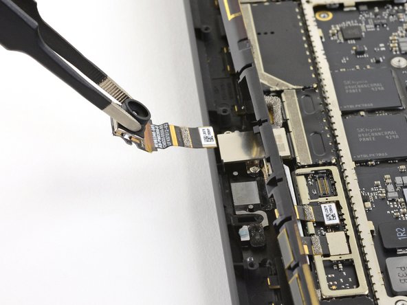

  47. Microsoft Surface Pro X Front Camera Replacement, Detach the front camera: étape 47, image 1 de 2 Microsoft Surface Pro X Front Camera Replacement, Detach the front camera: étape 47, image 2 de 2
    • The front camera is secured to the frame with light adhesive.
    • Insert the pointed end of a spudger under the top left corner of the front camera.
    • Lift the front camera up to detach it from the frame.
  48. Microsoft Surface Pro X Front Camera Replacement: étape 48, image 1 de 2 Microsoft Surface Pro X Front Camera Replacement: étape 48, image 2 de 2
    • Insert an opening pick under the top edge of the front camera.
    • Slide the opening pick under the front camera toward its connector to cut through the adhesive.
    • If the adhesive is too difficult to cut through, follow these steps:
    • Apply a few drops of high-concentration (90% or higher) isopropyl alcohol to the left edge of the front camera.
    • Wait thirty seconds for the isopropyl alcohol to weaken the adhesive.
    • Use an opening pick to cut through the adhesive under the front camera.
    • Only apply as much isopropyl alcohol as needed while removing the front camera. Isopropyl alcohol may permanently obscure the front and rear camera lenses, causing blurry photos.
  49. Microsoft Surface Pro X Front Camera Replacement, Remove the front camera: étape 49, image 1 de 3 Microsoft Surface Pro X Front Camera Replacement, Remove the front camera: étape 49, image 2 de 3 Microsoft Surface Pro X Front Camera Replacement, Remove the front camera: étape 49, image 3 de 3
    • Use a pair of blunt tweezers to lift and remove the front camera.
    • During reassembly, make sure to insert the peg on the frame into the hole in the front camera cable.
    • The peg is located to the right of the front camera.
