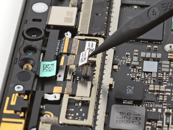

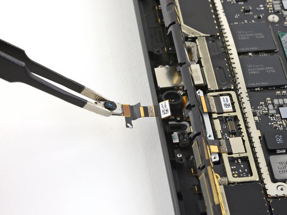

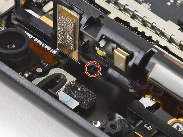

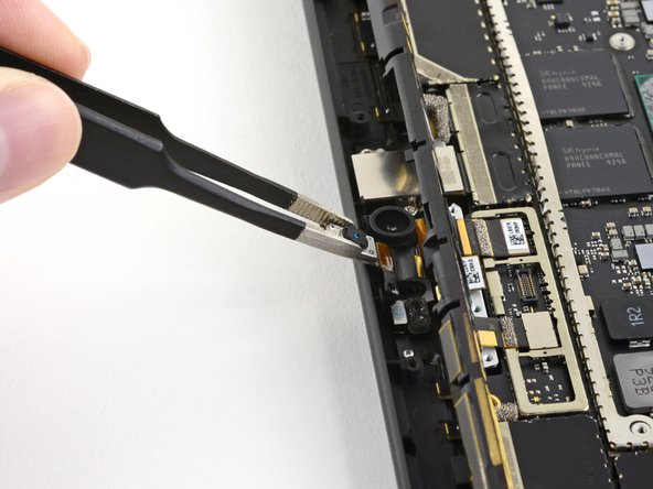

  35. Microsoft Surface Pro X Windows Hello Face Camera Replacement, Remove the front camera shield: étape 35, image 1 de 2 Microsoft Surface Pro X Windows Hello Face Camera Replacement, Remove the front camera shield: étape 35, image 2 de 2
    Outil utilisé dans cette étape :
    • Insert one tine of a pair of pointed tweezers under one corner of the shield covering the front camera connector.
    • Lift up the corner to detach it from the frame.
    • If you are going to reuse this shield, try to avoid excessively bending it during removal.
  36. Microsoft Surface Pro X Windows Hello Face Camera Replacement: étape 36, image 1 de 3 Microsoft Surface Pro X Windows Hello Face Camera Replacement: étape 36, image 2 de 3 Microsoft Surface Pro X Windows Hello Face Camera Replacement: étape 36, image 3 de 3
    • Repeat the previous step for the other three corners of the shield.

  42. Microsoft Surface Pro X Windows Hello Face Camera Replacement, Disconnect the Windows Hello face camera: étape 42, image 1 de 2 Microsoft Surface Pro X Windows Hello Face Camera Replacement, Disconnect the Windows Hello face camera: étape 42, image 2 de 2
    • Use the pointed end of a spudger to disconnect the Windows Hello face camera press connector from its socket.

  47. Microsoft Surface Pro X Windows Hello Face Camera Replacement, Remove the Windows Hello face camera: étape 47, image 1 de 3 Microsoft Surface Pro X Windows Hello Face Camera Replacement, Remove the Windows Hello face camera: étape 47, image 2 de 3 Microsoft Surface Pro X Windows Hello Face Camera Replacement, Remove the Windows Hello face camera: étape 47, image 3 de 3
    • Use the pointed end of a spudger to flip down the top edge of the Windows Hello face camera and detach it from the sensor bar.
    • During reassembly, make sure to insert the peg on the sensor bar into the hole in the Windows Hello face camera cable.
    • The peg is adjacent to the left microphone.
  48. Microsoft Surface Pro X Windows Hello Face Camera Replacement: étape 48, image 1 de 3 Microsoft Surface Pro X Windows Hello Face Camera Replacement: étape 48, image 2 de 3 Microsoft Surface Pro X Windows Hello Face Camera Replacement: étape 48, image 3 de 3
    • Use a pair of blunt tweezers to lift and remove the Windows Hello face camera.
