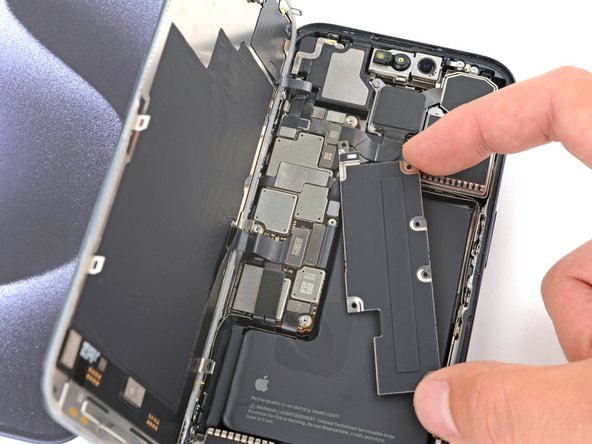

  18. iPhone 15 Pro Front Camera Assembly Replacement, Unfasten the logic board cover: étape 18, image 1 de 2 iPhone 15 Pro Front Camera Assembly Replacement, Unfasten the logic board cover: étape 18, image 2 de 2
    • Use a Y000 screwdriver to remove the six screws securing the logic board cover:
    • Four 1.6 mm‑long screws
    • Two 1.3 mm‑long screws
  19. iPhone 15 Pro Front Camera Assembly Replacement, Remove the logic board cover: étape 19, image 1 de 3 iPhone 15 Pro Front Camera Assembly Replacement, Remove the logic board cover: étape 19, image 2 de 3 iPhone 15 Pro Front Camera Assembly Replacement, Remove the logic board cover: étape 19, image 3 de 3
    • Rotate the bottom of the logic board cover counterclockwise and slide the top left corner out from under the ambient light sensor cable to remove it.
    • During reassembly, make sure the top left corner of the cover goes under the ambient light sensor cable.

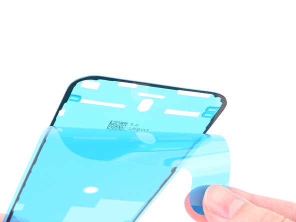

  23. iPhone 15 Pro Front Camera Assembly Replacement, Remove the screen: étape 23, image 1 de 2 iPhone 15 Pro Front Camera Assembly Replacement, Remove the screen: étape 23, image 2 de 2
    • Remove the screen.
    • During reassembly, follow this guide to apply new adhesive and install your screen.
    • Be careful not to damage any of the spring contacts as you clean the frame.

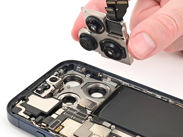

  26. iPhone 15 Pro Front Camera Assembly Replacement, Remove the rear cameras: étape 26, image 1 de 3 iPhone 15 Pro Front Camera Assembly Replacement, Remove the rear cameras: étape 26, image 2 de 3 iPhone 15 Pro Front Camera Assembly Replacement, Remove the rear cameras: étape 26, image 3 de 3
    • Be careful not to touch or smudge the camera lenses during this step.
    • Insert the point of a spudger between the top right corner of the rear cameras and frame.
    • Pry up until you can grab the rear cameras with your fingers.
    • Remove the rear cameras.

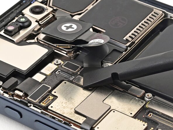

  29. iPhone 15 Pro Front Camera Assembly Replacement, Move the microphone cable: étape 29, image 1 de 3 iPhone 15 Pro Front Camera Assembly Replacement, Move the microphone cable: étape 29, image 2 de 3 iPhone 15 Pro Front Camera Assembly Replacement, Move the microphone cable: étape 29, image 3 de 3
    • The microphone cable covers the front sensors press connector.
    • Use the tip of an opening pick to disconnect the microphone press connector from the top left corner of the logic board.
    • Lift the cable out of the way so you can access the two press connectors on the logic board's top edge.

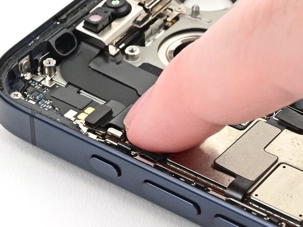

  34. iPhone 15 Pro Front Camera Assembly Replacement, Connect the front camera assembly: étape 34, image 1 de 3 iPhone 15 Pro Front Camera Assembly Replacement, Connect the front camera assembly: étape 34, image 2 de 3 iPhone 15 Pro Front Camera Assembly Replacement, Connect the front camera assembly: étape 34, image 3 de 3
    • Use your finger or the flat end of a spudger to connect the front camera assembly's press connectors to their sockets on the top edge of the logic board.
  35. iPhone 15 Pro Front Camera Assembly Replacement, Connect the microphone: étape 35, image 1 de 2 iPhone 15 Pro Front Camera Assembly Replacement, Connect the microphone: étape 35, image 2 de 2
    • Use your finger to connect the microphone press connector to its socket on the top left corner of the logic board.

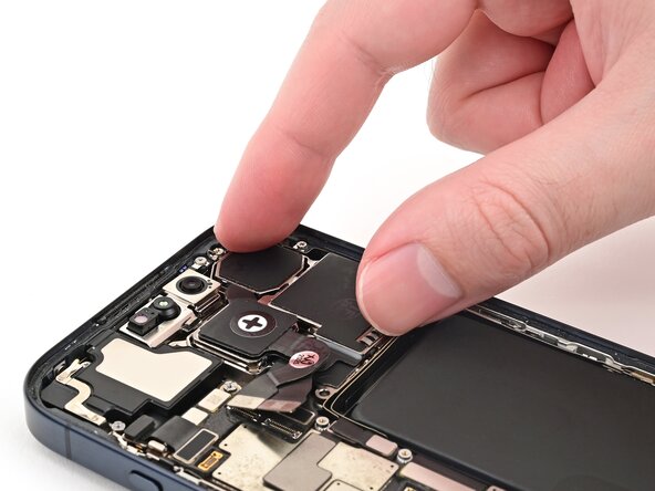

  38. iPhone 15 Pro Front Camera Assembly Replacement, Install the rear camera assembly: étape 38, image 1 de 3 iPhone 15 Pro Front Camera Assembly Replacement, Install the rear camera assembly: étape 38, image 2 de 3 iPhone 15 Pro Front Camera Assembly Replacement, Install the rear camera assembly: étape 38, image 3 de 3
    • Be careful not to touch or smudge the camera lenses.
    • Align the rear camera assembly with its recess in the frame and set it into place.

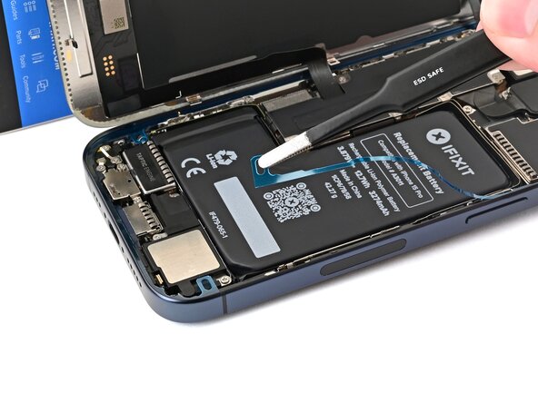

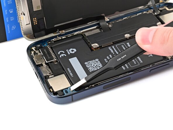

    • The adhesive remaining on the phone is difficult to remove and leaves residue. If you have trouble removing the adhesive, apply some heat using a hair dryer or heat gun.
    • Use a spudger to push the screen adhesive up until you can grab it with a pair of tweezers.
    • Use a pair of tweezers, or your fingers, to remove the adhesive around the entire perimeter of the iPhone.

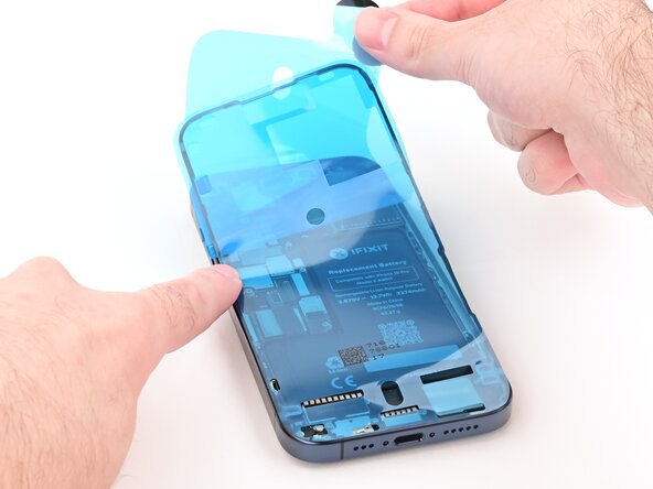

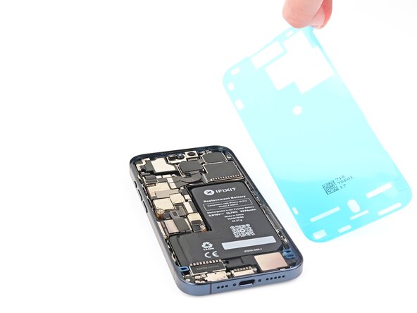

  43. iPhone 15 Pro Front Camera Assembly Replacement, Orient the adhesive: étape 43, image 1 de 1
    • Lay the adhesive next to the phone and use features like cutouts for spring contacts and the front‑facing camera to orient it correctly.
  44. iPhone 15 Pro Front Camera Assembly Replacement, Apply the adhesive: étape 44, image 1 de 3 iPhone 15 Pro Front Camera Assembly Replacement, Apply the adhesive: étape 44, image 2 de 3 iPhone 15 Pro Front Camera Assembly Replacement, Apply the adhesive: étape 44, image 3 de 3
    • Once the adhesive is pressed into place, you can't reposition it—you'll have to remove it and start over with new adhesive.
    • Use the pull tab to begin peeling the back liner off of the adhesive starting from the bottom, but don't remove it all the way.
    • While holding the back liner out of the way, carefully align the exposed edge of the adhesive to the bottom edge of the iPhone's frame.
    • When the adhesive is aligned, set it down along the bottom edge.
  45. iPhone 15 Pro Front Camera Assembly Replacement: étape 45, image 1 de 3 iPhone 15 Pro Front Camera Assembly Replacement: étape 45, image 2 de 3 iPhone 15 Pro Front Camera Assembly Replacement: étape 45, image 3 de 3
    • Continue peeling the back liner off of the adhesive while setting the adhesive into place along the edges of the iPhone's frame.
    • If you correctly aligned the lower edge of the adhesive, the side and top edges will fall perfectly into place. If the adhesive is misaligned, remove it and start over with new adhesive.

  50. iPhone 15 Pro Front Camera Assembly Replacement, Connect the screen and ambient light sensor: étape 50, image 1 de 3 iPhone 15 Pro Front Camera Assembly Replacement, Connect the screen and ambient light sensor: étape 50, image 2 de 3 iPhone 15 Pro Front Camera Assembly Replacement, Connect the screen and ambient light sensor: étape 50, image 3 de 3
    • Use your finger or the flat end of a spudger to connect the screen and ambient light sensor press connectors.

  52. iPhone 15 Pro Front Camera Assembly Replacement, Install the logic board cover: étape 52, image 1 de 3 iPhone 15 Pro Front Camera Assembly Replacement, Install the logic board cover: étape 52, image 2 de 3 iPhone 15 Pro Front Camera Assembly Replacement, Install the logic board cover: étape 52, image 3 de 3
  53. iPhone 15 Pro Front Camera Assembly Replacement, Fasten the logic board cover: étape 53, image 1 de 1
    • Use a Y000 screwdriver to install the six screws securing the logic board cover:
