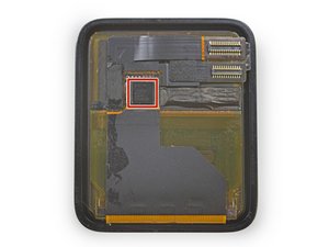

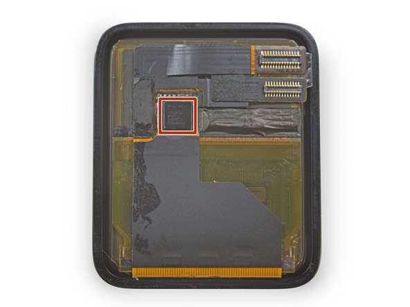

@adamusik - Take a look at these two images and tell me if they use the same connector system
Original Apple watch (gen1)
Series 1 (gen2) & 2 as well as Series 3 which uses a different part
These parts are NOT interchangeable!!

Dan first picture is Original Series and series 1 (models A1553, A1554, A1802 and A1803)
second picture is series 2 and 3 (models A1757, A1758 and series 3)
