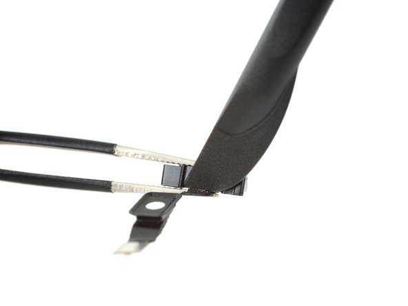

  24. iPad Air 3 Power Button Cable Replacement, Remove the power button cable: étape 24, image 1 de 3 iPad Air 3 Power Button Cable Replacement, Remove the power button cable: étape 24, image 2 de 3 iPad Air 3 Power Button Cable Replacement, Remove the power button cable: étape 24, image 3 de 3
    Outil utilisé dans cette étape :
    • Grip the power button bracket with a pair of tweezers.
    • Use an opening pick or halberd spudger to peel the power button cable away from the bracket.
  25. iPad Air 3 Power Button Cable Replacement: étape 25, image 1 de 3 iPad Air 3 Power Button Cable Replacement: étape 25, image 2 de 3 iPad Air 3 Power Button Cable Replacement: étape 25, image 3 de 3
    • Use an opening pick or a halberd spudger to peel the power button cable away from the bracket.
    • Remove the power button cable.
    • Compare your new replacement part to the original part—you may need to transfer remaining components or remove adhesive backings from the new part before you install it.
    • During reassembly, transfer the ambient light sensor gasket over to the new power button cable.
