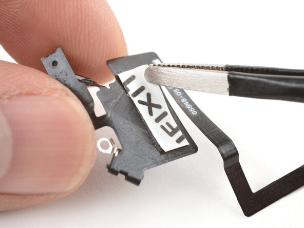

  30. iPhone 17 Pro Max Screen Replacement, Attach the front sensors: étape 30, image 1 de 2 iPhone 17 Pro Max Screen Replacement, Attach the front sensors: étape 30, image 2 de 2
    Outil utilisé dans cette étape :
    Tesa 61395 Tape
    $2.95
    • The next four steps show how to attach the front sensors to the replacement screen. If your screen comes with front sensors preinstalled, skip down four steps.
    • Use your finger to press the rectangular section of the front sensors cable onto the screen.
    • Use a hair dryer or iOpener to soften the adhesive under the cable to help it stick. It only needs to be warm—not hot.
    • If the cable isn't sticking, apply a small piece of double-sided tape to the back of the cable.

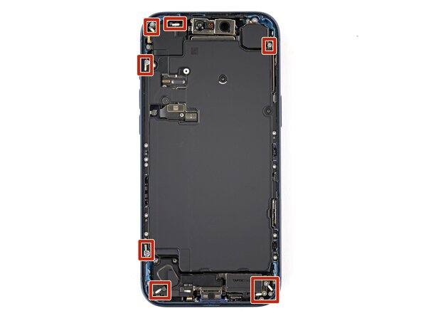

  34. iPhone 17 Pro Max Screen Replacement, Clean the frame: étape 34, image 1 de 3 iPhone 17 Pro Max Screen Replacement, Clean the frame: étape 34, image 2 de 3 iPhone 17 Pro Max Screen Replacement, Clean the frame: étape 34, image 3 de 3
    • Work around the fragile grounding clips as you clean the frame. If you bend one out of place, gently bend it back with your fingers or tweezers.
    • Use tweezers or your fingers to remove large pieces of adhesive from the frame perimeter.
    • Use a spudger to scrape the adhesive residue off the frame.
    • If the adhesive feels stubborn, apply some heat using a hair dryer or heat gun and try again.

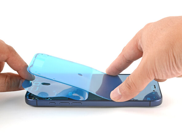

  37. iPhone 17 Pro Max Screen Replacement, Orient the replacement adhesive: étape 37, image 1 de 2 iPhone 17 Pro Max Screen Replacement, Orient the replacement adhesive: étape 37, image 2 de 2
    • Without peeling any liners, lay the adhesive sheet over the frame to determine its proper orientation.
    • Use features such as the camera cutout and notches along the top and bottom edges to visualize how the adhesive will lay in the frame.
    Demander à FixBot
    Ajouter un commentaire

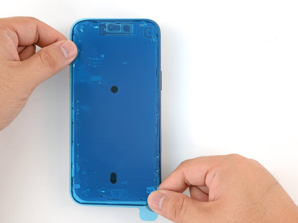

  38. iPhone 17 Pro Max Screen Replacement, Apply the replacement adhesive: étape 38, image 1 de 1
    • Grab the tab in the corner of the adhesive sheet and peel the liner to expose a third of the adhesive.
    • The exposed adhesive is very sticky. Don't let it touch anything until you're ready to apply it to the frame.
    • If your adhesive has multiple liners, peel the liner that exposes the side that sticks to the frame.
    Demander à FixBot
  39. iPhone 17 Pro Max Screen Replacement: étape 39, image 1 de 2 iPhone 17 Pro Max Screen Replacement: étape 39, image 2 de 2
    • Once the adhesive is pressed into place, you can't reposition it—you'll have to remove it and start over with new adhesive.
    • Carefully align the exposed edge of the adhesive strip with the corresponding edge of the iPhone's frame.
    • When it's correctly aligned, gently press the exposed adhesive strip onto the frame.
    Demander à FixBot
  40. iPhone 17 Pro Max Screen Replacement: étape 40, image 1 de 3 iPhone 17 Pro Max Screen Replacement: étape 40, image 2 de 3 iPhone 17 Pro Max Screen Replacement: étape 40, image 3 de 3
    • Continue peeling away the liner from the adhesive as you gently press the adhesive into place.
    • If you've correctly aligned the adhesive, the edges will fall perfectly into place.
    • If your adhesive is slightly misaligned, gently pull the long edges into alignment with the frame.
    • If the adhesive begins to crease or wrinkle, remove it and start over with fresh adhesive.
    • If you don't have another set of adhesive strips handy, it's okay to temporarily put your iPhone back together and use it normally without any adhesive. Just keep in mind that your iPhone's water resistance will be compromised until you replace the adhesive.
    Demander à FixBot
  41. iPhone 17 Pro Max Screen Replacement: étape 41, image 1 de 1
    • Use a spudger to press the adhesive around the entire perimeter of your iPhone.
    • Work around the fragile grounding clips. If you bend one out of place, gently bend it back with your fingers or tweezers.
    Demander à FixBot
