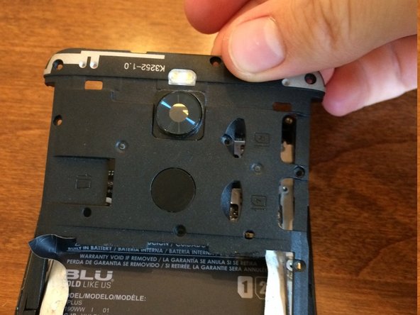

  5. BLU R2 Plus Fingerprint Sensor Replacement, Unscrew Upper Plastic Plate: étape 5, image 1 de 1
    • Use a Phillips #00 screwdriver to unscrew the nine screws from the upper plastic plate.

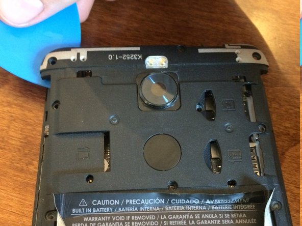

  6. BLU R2 Plus Fingerprint Sensor Replacement, Upper Plate Removal: étape 6, image 1 de 3 BLU R2 Plus Fingerprint Sensor Replacement, Upper Plate Removal: étape 6, image 2 de 3 BLU R2 Plus Fingerprint Sensor Replacement, Upper Plate Removal: étape 6, image 3 de 3
    • Using an opening pick to wedge under spaces around the upper plate, unclip the upper plate from the phone and slide it up and out.
  7. BLU R2 Plus Fingerprint Sensor Replacement, Fingerprint Sensor: étape 7, image 1 de 3 BLU R2 Plus Fingerprint Sensor Replacement, Fingerprint Sensor: étape 7, image 2 de 3 BLU R2 Plus Fingerprint Sensor Replacement, Fingerprint Sensor: étape 7, image 3 de 3
    Outil utilisé dans cette étape :
    • Use tweezers to carefully pull up the fingerprint sensor from the upper plate.
