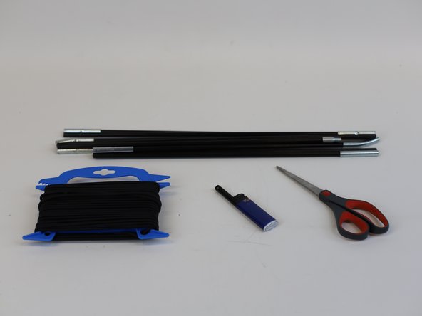

The elastic cords inside the tent poles can over extend due to constant use. It is important to replace them to make sure the tent structure remains sturdy. With a few simple tools and some patience, we will show you how to fix it and have your tent ready for your next outdoor excursion!
➡️Before you get started, please check the safety disclaimer at the bottom of the page.
Ce dont vous avez besoin
iFixit touche une commission lorsque vous achetez par l'intermédiaire de ces liens.
  1. How to Replace the Tent Poles Elastic, Identify the repair area: étape 1, image 1 de 2 How to Replace the Tent Poles Elastic, Identify the repair area: étape 1, image 2 de 2
    • Identify the repair area. In this example, the elastic needs to be replaced as it has over extended.
    • Prepare all the tools needed for the repair.
