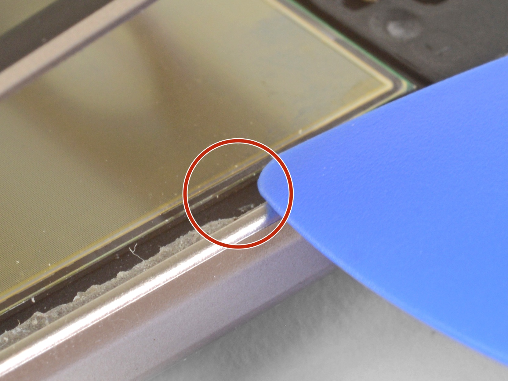

  13. Samsung Galaxy J3 (2016) Screen Replacement: étape 13, image 1 de 3 Samsung Galaxy J3 (2016) Screen Replacement: étape 13, image 2 de 3 Samsung Galaxy J3 (2016) Screen Replacement: étape 13, image 3 de 3
    • Insert the point of an opening pick under the bottom left corner of the AMOLED panel.
    • Use the indent on the edge of the frame to help getting the pick in place.
    • Slowly and firmly push the pick in to slice the adhesive underneath the AMOLED panel.
    • If you are having trouble inserting the pick, reheat an iOpener and apply it to the area for a minute before trying again.
